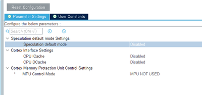

My default settings was MPU NOT used and cache disabled and Speculation Disabled.
Would Any MPU setting improve compared to this?
What else can I do?

I have tried: Strongly ordered, Device, Shared non shared, and Normal.
The only difference i see is when writing. in Normal it write 64bit boundaries filtered with DQS
in Strongly ordered and Device it only write the data.
Read behaves equally in all modes.
Typically the read will read 8 x 32 bit. (Can this be avoided?)
additional reads on next 64bit boundary will reads 2 x 32bit.
While reading in the same 64bit boundary no additional read are made. (This is the problem)
The Variable are defined as volatile and i have tried reading using various different method . lately using a console method where I can be sure that the compiler is not interfering.
as I see it it has to be related to Either the OctoSpi itself or something in the interface form the 64bit Axi-Bus to the Octospi.
If I write any address or read outside the 64bit boundary and go back then the value will be re-read once.

sCommand.InstructionSize = HAL_OSPI_INSTRUCTION_8_BITS;
sCommand.InstructionDtrMode = HAL_OSPI_INSTRUCTION_DTR_DISABLE;
sCommand.AddressMode = HAL_OSPI_ADDRESS_8_LINES;
sCommand.AddressSize = HAL_OSPI_ADDRESS_24_BITS;
sCommand.AddressDtrMode = HAL_OSPI_ADDRESS_DTR_DISABLE;
sCommand.AlternateBytesMode = HAL_OSPI_ALTERNATE_BYTES_NONE;
sCommand.DataMode = HAL_OSPI_DATA_8_LINES;
sCommand.DataDtrMode = HAL_OSPI_DATA_DTR_DISABLE;
sCommand.DQSMode = HAL_OSPI_DQS_ENABLE;
sCommand.SIOOMode = HAL_OSPI_SIOO_INST_EVERY_CMD;
sCommand.Address = 0;
sCommand.NbData = 1;
/* Memory-mapped mode configuration for Linear burst write operations */
sCommand.OperationType = HAL_OSPI_OPTYPE_WRITE_CFG;
sCommand.Instruction = LINEAR_BURST_WRITE;
sCommand.DummyCycles = DUMMY_CLOCK_CYCLES_SRAM_WRITE;
if (HAL_OSPI_Command(&hospi1, &sCommand, HAL_OSPI_TIMEOUT_DEFAULT_VALUE)!= HAL_OK) {
Error_Handler();
/* Memory-mapped mode configuration for Linear burst read operations */
sCommand.OperationType = HAL_OSPI_OPTYPE_READ_CFG;
sCommand.Instruction = LINEAR_BURST_READ;
sCommand.DummyCycles = DUMMY_CLOCK_CYCLES_SRAM_READ;
Error_Handler();
/*Disable timeout counter for memory mapped mode*/
sMemMappedCfg.TimeOutActivation = HAL_OSPI_TIMEOUT_COUNTER_ENABLE;
sMemMappedCfg.TimeOutPeriod = 100;
/*Enable memory mapped mode*/
if (HAL_OSPI_MemoryMapped(&hospi1, &sMemMappedCfg) != HAL_OK) {
Error_Handler();
Hope somebody can help with this
