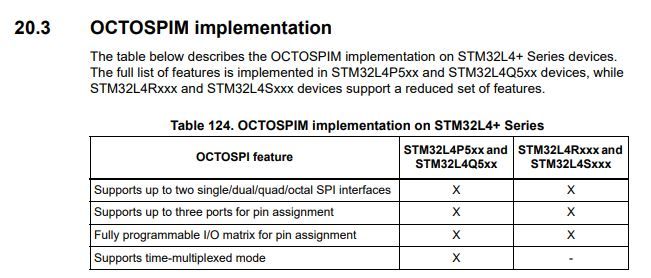

According to the datasheets, the STM32L4R9 LQFP100 devices should be able to support a multiplex hyperbus ram/flash device. (for example the cypress S71KSS12SCO)
But in STM32CubeMX, I'm unable to select the multiplexed hyperbus mode. I notice that I can with other devices like the STM32H7
Is this a problem with STM32CubeMX or am I not understanding the constraints and multiplexed hyperbus isn't supported on these devices after all?

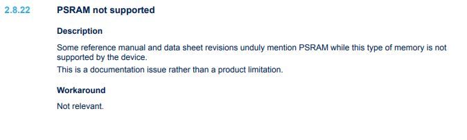

The multiplexed mode is not supported for STM32L4R/Sxxx series.
You can check the "Table 124. OCTOSPIM implementation on STM32L4+ Series", in the STM32L4+ Reference Manual (RM0432) described that the multiplexed mode is not supported for STM32L4R/Sxxx.
Note that the OCTOSPI-PSRAM memories (including HyperRAMs) are not supported in the STM32L4R/Sxxx products.
0693W00000Bbof2QAB.jpgFor more details, please have a look at the STM32L4Rxxx / STM32L4Sxxx errata sheet.
So, It's recommended to use Parallel PSRAM memories with FMC or to switch, if possible, to a STM32L4P5/Q5xx product which supports OCTOSPI PSRAM memories.

In fact, the PSRAM HyperRAM is available in the STM32L4R9-Eval, but due to the OCTOSPI limitations with PSRAMs, there is no longuer support OCTOSPI PSRAMs as described in the erratasheet.
