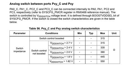

Yes I am using PC2_C and PC3_C - is there something I must take into consideration?
Thanks Tesla,
  • I have tried enable the compensation cell
  • I lowered GPIO speed from "very high" to "high" and "medium" - if that is what you meant?
  • I guess the load (or impedance) could be adjusted via the memory's register, but have not tried it yet, should be default 50 ohm and all traces are routed in 50 ohm.
  • Exactly the same bus set-up and clocking for both boards
I discovered that I used 30 ohms (5% tolerance) series resistors rather than 33 ohms due to lack in inventory but is a small margin and it should probably not be the cause. I am out of ideas and I begin thinking there perhaps could been some issue with the PCB stack-up during manufacturering.
YES. The xx_C are not good to drive hi-speed signals :
ds:
So you have about 400 ohms source resistance here +
xx_C should be used only for ADC input ...
and should not drive more > 1mA , otherwise you might kill it . (I did - so i know - with just the clock to a TFT on a xx_C pin. Testing TFT with 4MHz clock was ok, but then i switched to 16MHz - 1 screen written, then pin died. )
So dont use these pins for hi-speed signals - they cannot drive it. If you cannot change it now, try with
ed : low speed setting (400 ohm in series ! ) , just to verify your design is working. (maybe 2 MHz clock...)
