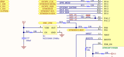

Indeed you are using HSI. It’s recommended to use HSE and a crystal for CAN communication. I don’t have my PC now (i’m posting with my phone) but the disco board has already a crystal (crystal oscillator XO).
So please use it instead of HSI:
You shoud select HSE in bypass mode and set the crystal value to 25MHz in the clock view.

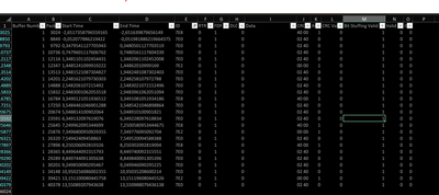

Please see the file attached , filter ID column with 7E and select all. You will see that DLC 0 and DATA empty and CRC invalid , not  ACKed and Valid 0.
TEC increased more than 127 , goes to error passive after a few milliseconds.
 02 01 0C with first byte 02 means it is a request for RPM in live mode (show current data). I don't even flood the bus since my requests are periodic with 1s , and i address it to each physical address from 7E0-7E7 and 7DF(broadcasting to all ECUs)

Principal III
Which means you almost certainly have a problem with the physical signal, either wiring, or missing/improper termination resistance.

So you have communication errors!
Frame not acked means, bitrate issue or hardware issue. I'm a bit surprised by this:
"I am able to receive CAN frames and able to log CAN frame frames it is just that frames sent are rejected"
What clock source are you using for FDCAN? HSI or HSE+Crystal?  if HSI, please use HSE + a crystal or any other external precise source.
