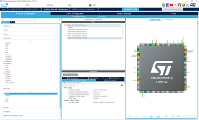

Hello forum,
I'm starting to develop a smart robotic system, I wanted to base the movement part on an STM32 micro-controller,
We thought about basing our SLAM on a camera and a simple distance sensor (and an IMU of course) for the initial mapping. the STM32U575ZI was supposed to support the DCMI interface and therefore is capable of handling such a task. but I just discovered that the Nucleo counterpart of the MCU isn't blocking the DCMI function. is there anything else I can do as a roundabout for this problem? maybe a different Nucleo that is more suited for such a task?
thanks in advance

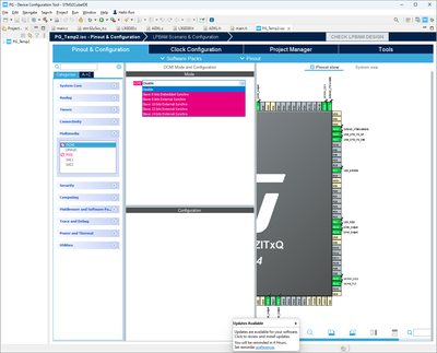

Hello @ElectroManiac
Just put the Cursor on the DCMI Mode that you want to use. Then, a pop-up will appear. This pop-up will show you how the pins that are posing the problem. Just disable the function of each Pins of those and the DCMI will be available for use:
PS: Make sure to use the Last Version of STM32CubeMX (V6.11.1).

thanks for the reply!
I'm sharing the MX configuration screen for the U575's Nucleo
Best Regards.
