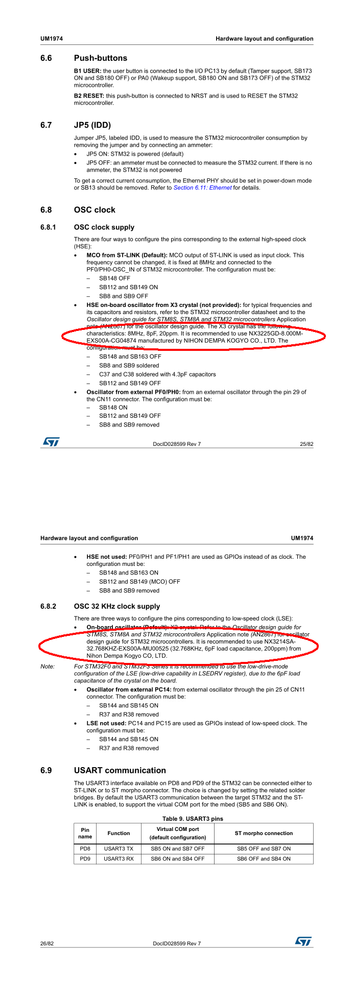

NUCLEO-H743ZI Is there a quartz resonator for the HSE signal on the NUCLEO-H743ZI board? Is there a quartz resonator for RTC on the NUCLEO-H743ZI board?
JKorp
Nucleo borads usualy have't resonator for high frequencies.
2 REPLIES 2
waclawek.jan
The NUCLEO boards typically deliver an 8 MHz reference from the ST-LINK's 8 MHz HSE source
X3 is not populated on the NUCLEO-H743ZI
