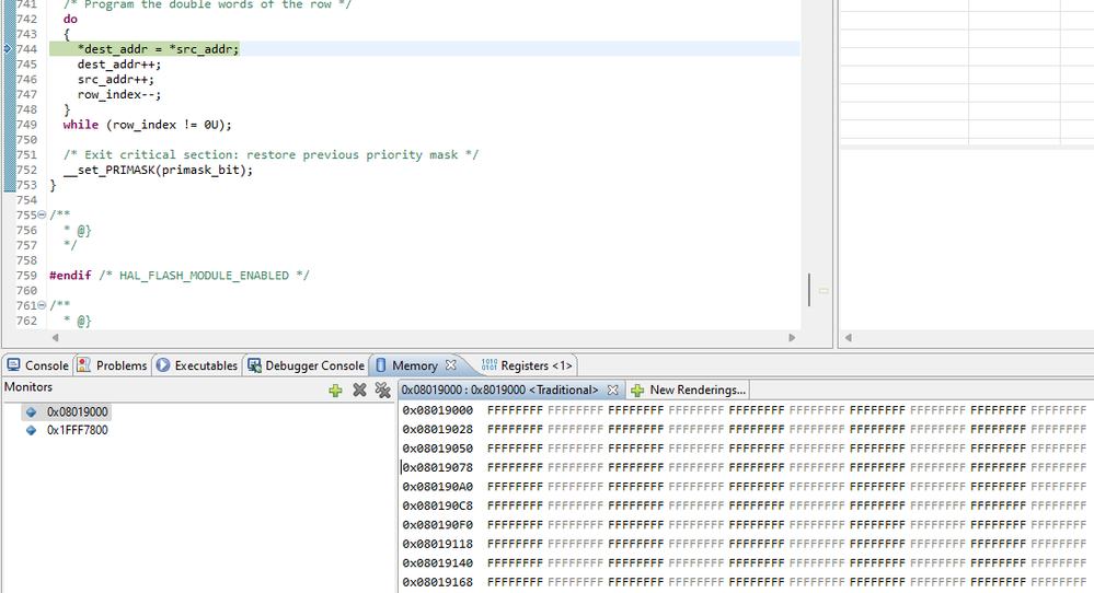

Even if the destination address in FLASH seems all erased however with the debugger I'm noticing that the highlighted piece of code is not transferring data from the origin address to flash. Here is a screen of the segment of code and flash that I'm trying to write to.
Flash unlocked? Volatile pointers with the correct addresses? Hard to debug without seeing full code. Memory doesn’t update automatically in IDE.
Should be CubeMX examples. Should also be flash status flags to check.

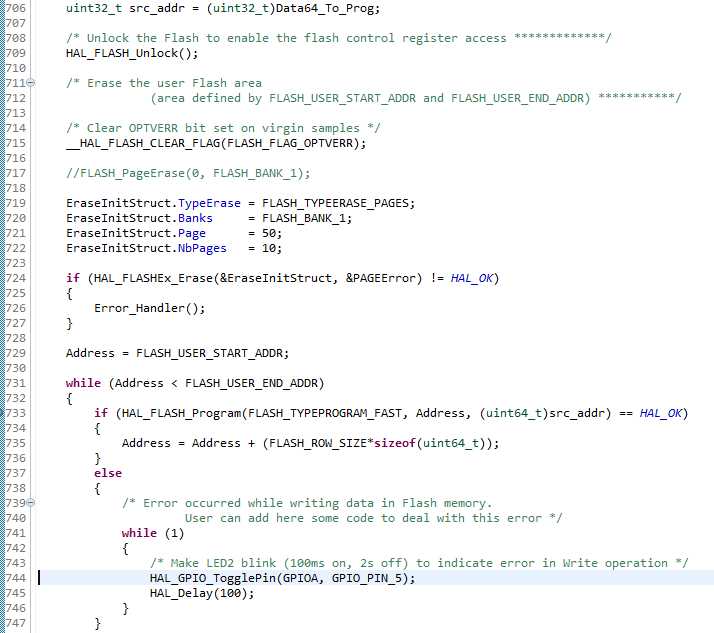

This is the structure of my flash management function, it is basically copy-pasted from the example provided by ST.
0693W00000JMFVsQAP.pngSo all the proper bits are set and managed by HAL libraries. This is perfectly identical (even the data to copy) to the ST example but is not writing anything while running the example itself works fine. I can't understand what is going on since they are identical...
