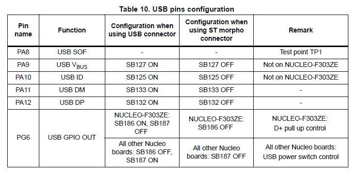

I am trying to configure a system to send data out CN13 on the Nucleo-F767ZI board. The CubeMX outputs seem to indicate this port is already set up:
100 PA8* USB_OTG_FS_SOF USB_SOF [TP1]
101 PA9* USB_OTG_FS_VBUS USB_VBUS
102 PA10* USB_OTG_FS_ID USB_ID
103 PA11* USB_OTG_FS_DM USB_DM
104 PA12* USB_OTG_FS_DP USB_DP
but there is no initialization of the port in the code (which I inherited).
I haven't been able to find much in the way of help in the programming manuals, so I thought I'd ask the community.
Thanks
    6 replies
    John Craven
    Senior
    October 27, 2017
    Posted on October 27, 2017 at 21:00
    From the Nuc-144 user manual;
    John Griswold
    Senior
    October 28, 2017
    Posted on October 28, 2017 at 16:24
    Thanks - that's apparently the default configuration. Now, which UART/USART can I connect to this USB? I am using 3, 4, & 5, so 1, 2, 6, 7, and 8 are available. Any suggestions?

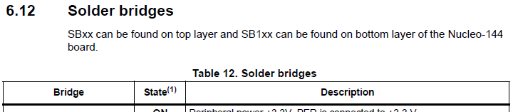

    This nucleo has two usb connectors. CN1 on the stlink and CN13 for USB OTG.

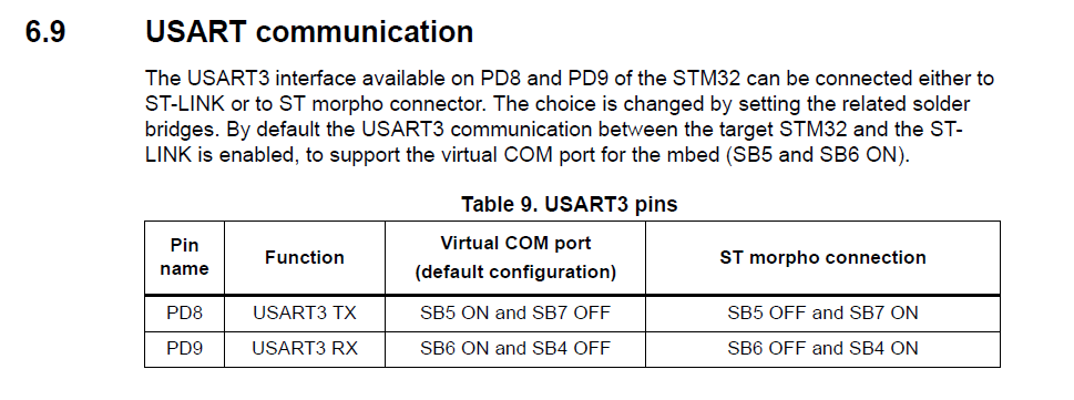

    Before we start, you should read 6.9 and 6.10 in Nuc-144 user man. UN1974

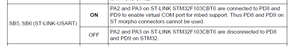

    If you just want to get going fast, the STLINK creates a VCP (on CN1 connector).
    The stlink connects to PD8/PD9 on the 767 (see schematic figure 16/17 in UM)
    These are also the alternate pins for USART3 TX/RX.
    If you are using Cube, enable USART 3. This enable PB10/PB
    Then gotoeach of
    PB10/PB10 pins
    and crtl-click them, and CUBE shows the alternates, PD8/PD9.
    Reassign them.

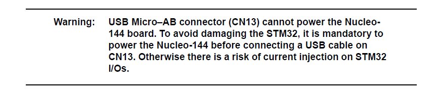

    If you really want to connect to CN13 using OTG.
    The CN13 is dead, until you put some USB stuff in your project.
    You have to setup USB_HS/FS and USB_CDC in your project.
    Finally, going back to the UM, make sure you read the warning;
    John Griswold
    Senior
    October 30, 2017
    Posted on October 30, 2017 at 17:57
    Thanks for your efforts, but we are taking the alternate path. I can't use STLink, as we've removed that board for size constraints, and the warnings about CN13 make me terribly reluctant to pursue that option. We're trying to get an FTDI interface card working.
