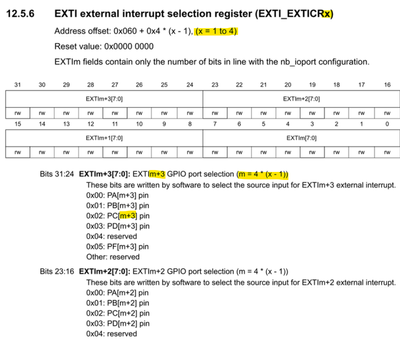

Need to set port C in EXTI_EXTICRx register.
in the interrupt, you should check for and clear the EXTI flag for pin 13 in EXTI_FPR1, and only turn on the LED if it's set. Don't need to do anything with NVIC functions or register.

Thank you TDK, I should've clarified, the interrupt is always on, when I set a breakpoint at the interrupt, it breaks all the time, hence the LED is always on.
I added code for FPR1 to clear that bit and the LED now blinks very fast that it is barely on, looks like d flicker.
I haven't figured out how to use EXTI_EXTICRx yet. Looks aweful convoluted and will take more time.
Thank you again.
‎2024-08-04 12:08 PM
The RM is a little confusing, but I think it's all written correctly.
> I need help with figuring out what x and m are and what exactly is nb_ioport?
For the EXTICR4 register, x=4. m = 4 * (x - 1) per the manual, so m=12 for this register.
nb_ioport is the pin number. It's 13 for PC3.
EXTICR1 configures pins 0-3, EXTICR2 configures pins 4-7, etc, so EXTICR4 configures pins 12-15.
x=4 in EXTICR4, so m = 4 * (x - 1) = 12, so you want to configure the EXTIm+1 register, which is bits 8-15. Write a 0x2 there.
EXTI_EXTICR1_EXTI0_0 is bit 0 of the EXTI_EXTICR1_EXTI0 field, and so on. This is the standard convention with all the CMSIS register defines.
Does that help?

What you have found (12.5.6 EXTI external interrupt) plus Table 47. EXTI controller register register map and reset values explains it. Yes, each 8-bit block in a EXTI_EXTICRx is a bitmap of the enableds ports.

See the highlighted regions. (EXTIm+1 is on the next page, same idea though.)
‎2024-08-04 12:46 PM
> Doesn't that mean that x1 is for bit 0-7
No, these are the GPIO port selection bits.
