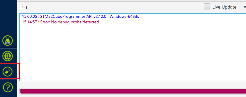

I use STM32GO1291. when I was debugging I got an error (its picture attached in below ) also my LD3 is not blinking anymore. is microcontroller damaged or there is some other things wrong? why it isn't blinking anymore when I plug!

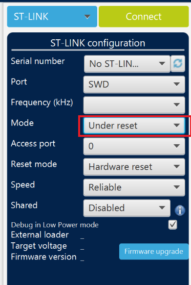

First you have to be able to load new firmware into the MCU. Can you connect under reset?
I suggest:
1- Downloading and installing STM32CubeProgrammer available under this link.
2- Trying to connect under reset
If you are able to connect, that means that the MCU isn't damaged and that your application is somehow preventing the debug access (by using PA13 or PA14 as GPIOs for example). You can then perform a full chip erase: 0693W00000WK6VhQAL.pngand download a led blink application. An example is located under:
STM32Cube/Repository/STM32Cube_FW_G0/Projects/NUCLEO-G031K8/Examples/GPIO/GPIO_IOToggle
If you can't connect, most probably the chip is damaged.
