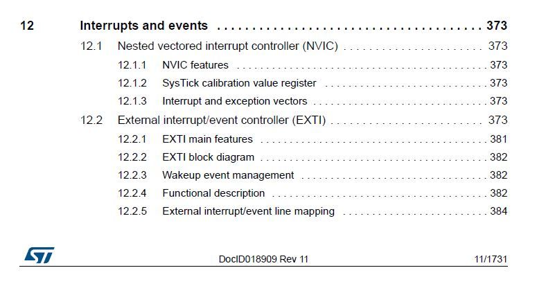

Typical when interrupt fires it does set X bit in the periephal register as a indication of the interrupt.
You would need to check the datasheet of your microcontroller to see which bit is set for each of those interrupts, then read the interesting bits to see which was the cause of the interrupt when the ISR fires.​
Ozone
Principal III
Usually one section in "Interrupts and Events".
Here an example from the F40x reference manual:
