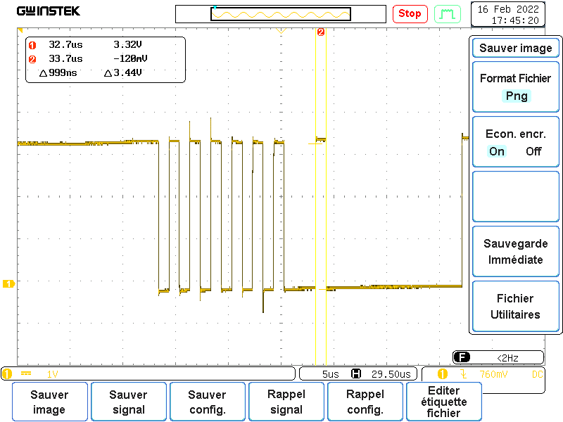

Hello, I m using the CAN bus on a STM32f412. It is connected to a transiver with a CAN analyser linked. I can receive messages without problem but i can t send any messages. Here is ho i configured the CAN :

and when i want to transmit, i do this :
TxHeader.StdId = 0x555;
TxHeader.RTR = CAN_RTR_DATA;
TxHeader.IDE = CAN_ID_STD;
TxHeader.DLC = 8;
TxHeader.TransmitGlobalTime = DISABLE;
for(int i = 0; i < 8; i++)TxData[i] = 0x1;
  /* Request transmission */
if(HAL_CAN_GetTxMailboxesFreeLevel(&hcan) != 3)
	HAL_CAN_AbortTxRequest(&hcan, 0);
	HAL_CAN_AbortTxRequest(&hcan, 1);
	HAL_CAN_AbortTxRequest(&hcan, 2);
HAL_GPIO_TogglePin(LED_vie_Port, LED_vie_Pin);
if(HAL_CAN_AddTxMessage(&hcan, &TxHeader, TxData, &TxMailbox) != HAL_OK)
    /* Transmission request Error */
    Error_Handler();
When i try so see frames with an osciloscope i get this :
0693W00000JQ3lXQAT.pngSo you can see the communication abort too early and i think it's because ther isn t stuffing bit.

Bouraoui Chemli
It seems there is no error in your code. Can you please share your project, the clock source and the baud rate to further check the configuration ?
Also, you can refer to CAN example provided in STM32CubeF4 via this link STM32Cube\Repository\STM32Cube_FW_F4_V1.x.y\Projects\STM324xG_EVAL\Examples\CAN\CAN_Networking
I suggest to run this example on your desk.
Bouraoui
Unfortunately, i can t send the whole project. but here is the clock configuration :
void SystemClock_Config(void)
  __HAL_RCC_PWR_CLK_ENABLE();
  __HAL_PWR_VOLTAGESCALING_CONFIG(PWR_REGULATOR_VOLTAGE_SCALE1);
  /** Initializes the CPU, AHB and APB busses clocks
  RCC_OscInitStruct.OscillatorType = RCC_OSCILLATORTYPE_HSI|RCC_OSCILLATORTYPE_LSI;
  RCC_OscInitStruct.LSIState = RCC_LSI_ON;
  RCC_OscInitStruct.PLL.PLLSource = RCC_PLLSOURCE_HSI;
  RCC_OscInitStruct.PLL.PLLM = 8;
  RCC_OscInitStruct.PLL.PLLN = 100;
  RCC_OscInitStruct.PLL.PLLP = RCC_PLLP_DIV2;
  RCC_OscInitStruct.PLL.PLLQ = 4;
  RCC_OscInitStruct.PLL.PLLR = 2;
  HAL_RCC_OscConfig(&RCC_OscInitStruct);
  RCC_ClkInitStruct.APB1CLKDivider = RCC_HCLK_DIV2;
  RCC_ClkInitStruct.APB2CLKDivider = RCC_HCLK_DIV1;
  HAL_RCC_ClockConfig(&RCC_ClkInitStruct, FLASH_LATENCY_3);
And the baud rate is at 1Mbit/s.
I also tested the same configuration in loopback mode and here i hadn't any problem, i received and sent valid frames. Moreover i had the good signal on Rx and Tx pin.
