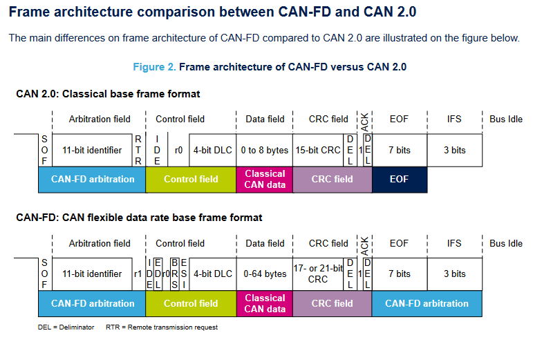

I would like to connect, on the same CAN bus, two different microcontrollers, one uses FDCAN and the other on is using CAN 2.0. Is it possible for them both to communicate ? Also, can i configure the FDCAN RXD interrupt ?

@Community member​ you should take a lok at AN5348
page 2:
CAN-FD features
Main features of the CAN-FD protocol are listed below:
Compatibility with the CAN protocol: CAN-FD node is able to send/receive CAN messages according to
ISO 11898-1
page5:
And this is why FDCAN supports CAN2.0, the data frames are very similar

I understand that I must configure the frame Format on Classic mode in order to send/receive CAN 2.0 frames with the FDCAN controller.
There is also some configuration to set up the bus timings (Mbit/s - timeseg1 - timeseg2 ...)

What about the CRC length if a CAN 2.0 MCU communicate with a FDCAN MCU in classic mode ??

In Classic mode, FDCAN behaves as classical CAN.
See example provided in STM32CubeH7 under the path: Projects\STM32H743I-EVAL\Examples\FDCAN\FDCAN_Classic_Frame_Networking
This example shows how to send/receive classical CAN frames using FDCAN peripheral to/from STM32 MCUs featuring bxCAN like STM32F1, STM32F4 families etc ..
