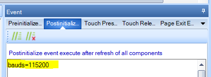

0693W000001qeRtQAI.pngHello
I have Nextion display. Ican control it with arduino library in Arduino ide good.
I am learning communication nextion without itead nextion library via uart.
I designed simply page in nextion. it has just a textbox named "t0".
I try send a word from STM32F103C8T6 , but i couldnt. This my code pls tell me what is wrong.I use STM32CubeIDE 1.3
Thanks for advance.

You can't just cast 0xFF to a pointer, and do strlen() on it either.
Use
uint8_t ch = 0xFF;
​H​AL_UART_Transmit(&huart2, &ch,1, 20);

I set baud 115200 in nextion and st mcu. it is ok.
I try this code but issue is continious. I cant send any data display but i can send data to pc via uart .
What is my fault?
 char dizi[]="t0.txt=\"dene\"\r\n";
	 HAL_UART_Transmit(&huart2,&dizi,strlen(dizi),50);
	// HAL_UART_Transmit(&huart2,(uint8_t*)dizi,strlen(dizi),20); or i tried this line same result
	 uint8_t ch = 0xFF;
	 HAL_UART_Transmit(&huart2, &ch, 1, 20);
 HAl_Delay(800);
