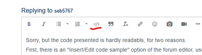

Sorry, but the code presented is hardly readable, for two reasons.
First the format - there is an "Insert/Edit code sample" option of the forum editor, use it :
Second, you almost exclusively use "magic numbers".
I'm not willing to wade through the reference manual just to check your code.
There are device header files with definitions of speaking names and macros, it doesn't hurt to use those.
And you immediately understand the intention of you own code even months or years later ...
