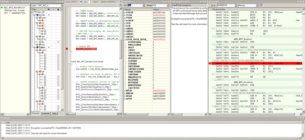

When enabling the MPU I get a a hard fault exception when accessing the SCB->SHCSR Register (@ addr. 0XE000EDF8. See marked line in Dissasembly Windows. The Fault Viewer dumps following message:
The processor has escalated a configurable-priority exception to HardFault.
   An MPU or Execute Never (XN) default memory map access violation has occurred on an instruction fetch (CFSR.IACCVIOL, MMFAR).
   A derived MemManage fault occurred on exception entry (CFSR.MSTKERR, MMFAR).
Exception occured at PC = 0xa3f36560, LR = 0xf37590
See the call stack for more information.

Following Image of debugger I got:
