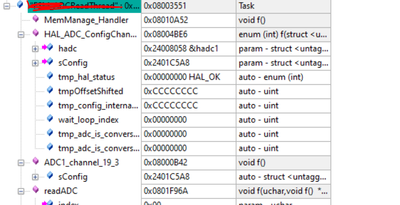

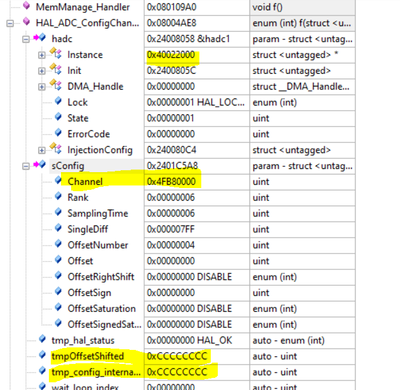

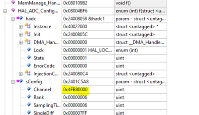

Please refer to the image above. I can now confirm that hadc1.Instance correctly points to ADC1 at address 0x40022000; however, sConfig.Channel appears to be mapped to an incorrect memory location. Any suggestions to help resolve this issue would be helpful. Thank you.
> ... however, sConfig.Channel appears to be mapped to an incorrect memory location.
I don't know what this sConfig / Channel parameter are used for, I don't use Cube/HAL in any of my projects.
But it is supposedly related to the channel setup, and most probably not the cause for the MPU fault.
I suggest to debug in single-step mode, to see which access actually triggers the MPU fault.
Or retrieve the fault address from the respective Syscfg register in the fault handler afterwards, and crosscheck with the map file.

>> ..Yes, With the MPU disabled, ADC initialization functions correctly without errors. However, when the MPU is enabled, Memory Management faults occur specifically with ADC1/2 peripherals, whereas ADC3 continues to operate normally.
The Memory Management fault occurs when executing the following line:
tmpOffsetShifted = ADC_OFFSET_SHIFT_RESOLUTION(hadc, (uint32_t)sConfig->Offset);
      /* Shift the offset with respect to the selected ADC resolution. */
      /* Offset has to be left-aligned on bit 11, the LSB (right bits) are set to 0 */
#if defined(ADC_VER_V5_V90)
      if (hadc->Instance == ADC3)
        tmpOffsetShifted = ADC3_OFFSET_SHIFT_RESOLUTION(hadc, (uint32_t)sConfig->Offset);
      else
#endif /* ADC_VER_V5_V90 */
Please find the Memory address.
I'm not sure if you understand the functionality of such a unit.
A MPU does no address translation or manipulation like e.g. a MMU. You can define restrictions to the read, write and execution access of memory ranges, so as to block parts of code from accessing data or code reserved for other parts. The most common use case is to separate OS code from user application code, e.g. in FreeRTOS or similiar OSes.
Thus :
> The Memory Management fault occurs when executing the following line:  ...
The C source code does not help.
The actual memory address the access to which causes the fault is required, which is unambigiously visible only in assembler code - and core register contents.
I don't know what your use case for the MPU is here.
As an example, referring to the FreeRTOS example mentioned above, user code is usually not allowed to access peripherals directly, only via the OS API. All of the ECUs my company employs enforce this rule strictly.
