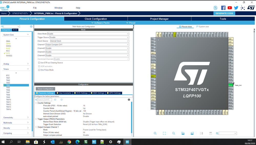

i am trying to make PWM from internal clock. i use TIM4 with out put is pin PD12.
i just put the code bellow in INT VOID(MAIN)
HAL_TIM_PWM_Start(&htim4, TIM_CHANNEL_1);
But it doesn't work.
Can someone help me explain?

You need to initialize the pins and timer first. Use STM32CubeMX to generate the code for you, or look at examples in the CubeF4 repository.
KUSAGI
Thanks you for reply,
i initialize the pin already. i was follow on youtube how to make pwm. and did base on that. but not effect

initialize pin timer
> can you give me some examples?
Here is one example:
https://github.com/STMicroelectronics/STM32CubeF4/blob/b5abca20c9676b04f8d2885a668a9b653ee65705/Projects/STM32446E_EVAL/Examples/TIM/TIM_PWMOutput/Src/main.c
