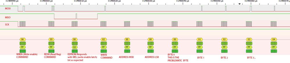

I am working on a library for controlling the
http://www.st.com/content/ccc/resource/technical/document/datasheet/11/47/cf/4a/88/23/42/87/CD000014pdf/files/CD000014pdf/jcr:content/translations/en.CD000014pdf
from an STM32 device. I have the library writing and reading back data however the first byte of each page it not as expected and seems to be fixed at
0x04
For example I write 128 bytes across two pages starting at
0x00
address with value
0x80
. When read back I get:
byte[0] = 0x04;
byte[1] = 0x80;
byte[2] = 0x80;
byte[3] = 0x80;
byte[64] = 0x04;
byte[65] = 0x80;
byte[66] = 0x80;
byte[67] = 0x80;

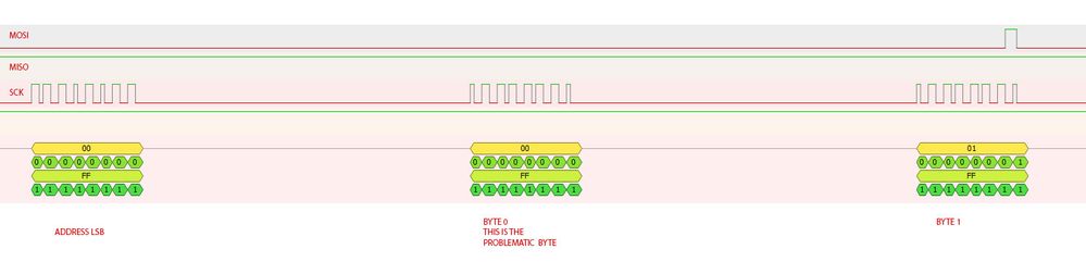

I have debugged the SPI with a logic analyzer and confirmed the correct bytes are being sent. When using the logic analyzer on the read command the mysterios
0x04
is transmitted from the EEPROM.
Here is my code:

Additionally I have tried writing sequentially 255 bytes increasing data to check for rollover. The results are as follows:
byte[0] = 4; // Incorrect Mystery Byte
byte[1] = 1; byte[2] = 2;
byte[3] = 3;
byte[63] = 63;
byte[64] = 4; // Incorrect Mystery Byte
byte[65] = 65;
byte[66] = 66;
byte[127] = 127;
byte[128] = 4; // Incorrect Mystery Byte
byte[129} = 129;
Pattern continues. I have also tried writing just 8 bytes from address 0x00 and the same problem persists so I think we can rule out rollover.
I have tried removing the debug printConsole and it has had no effect.
Here is a SPI logic trace of the write command:
And a close up of the first byte that is not working correctly:

Posted on February 22, 2017 at 17:18
Show the chip select in the context of the signals being diagrammed here
