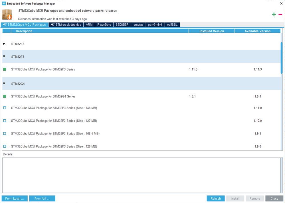

Thanks! do you know how do I download the files from GitHub?
I have never used it before.
You use CubeMX to download the firmware.
Here is F3 and G4 already downloaded.
Then navigate to the Repository folder.
for F3 >>> Repository\STM32Cube_FW_F3_V1.11.3\Projects\STM32F3348-Discovery\Examples\HRTIM\HRTIM_TM_PFC
for G4 >>> Repository\STM32Cube_FW_G4_V1.5.1\Projects\B-G474E-DPOW1\Examples_MIX\HRTIM\HRTIM_PFC_TransitionMode
