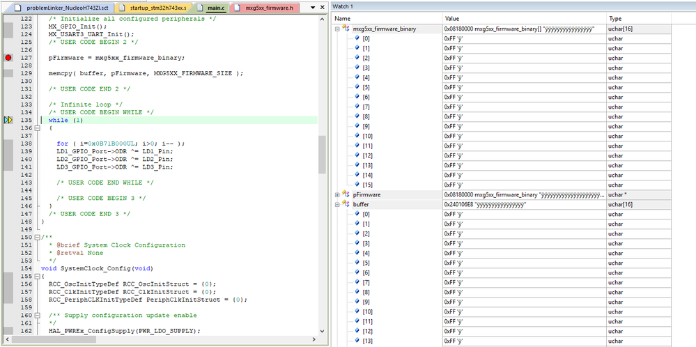

I have a const uint8_t array which I want to place in the flash at a specific location. The location is Address: 0x08180000. For that reason I created a *.sct file. The used tag is "MXG5XX".

If I start debugging now the address for the const array is correct (0x08180000) but the memory at this address shows only 0xFF and not the values defined for the array.

The base addresses need to be consistent, you can't have the data floating in the middle of the load region, the scatter loader wants to unpack it.

Split into two load regions, with the second describing the last 512KB, and put the second execution region inside that.
2020-07-15 4:54 AM
... Thank you. This version works.
