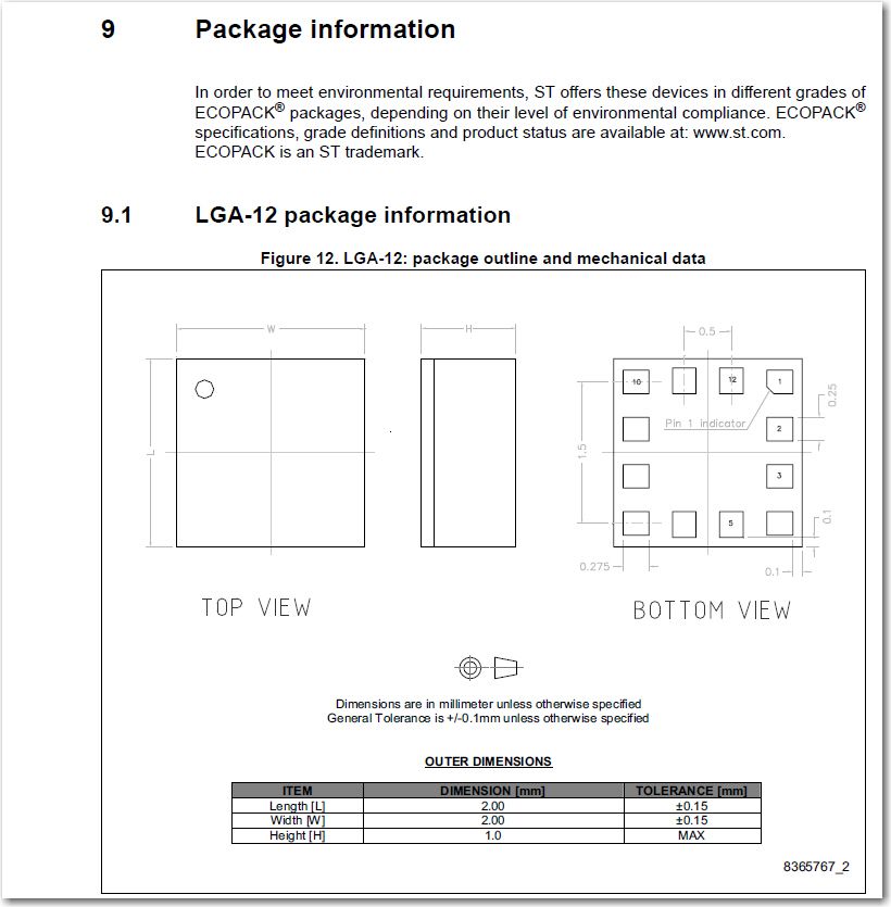

Dear Members or ST Employee,
I tried to check the connection on LGA-12 package,
Is it possible that I put extra pad larger horizontally so it's easier to check?
Currently I used the same size as in datasheet
3 REPLIES 3
Put test pads off on thin stalks, so you don't have to put solder down everywhere
any photo example ? I don't understand by "test pads on thin stalks"?
antonius
Senior
may be extra pad to the left, up, down and right, so I can check with my connectivity tester ?
