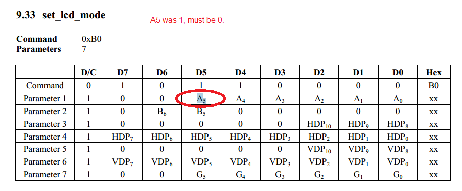

Progress:
I found some information about the driver board: connection between ssd1963 and lcd panel is 18 bits width, the first parameter of set_lcd_mode (0xb0) was set as 0x0020, which refers to a 24 bit connection, I changed it to 0x0000 (actually I need to set bit A5 of the first parameter to 0, instead of 1).
By doing this, colors are shown OK, black is black, yellow is yellow etc. but...
The system hangs when I want to change color to GUI_WHITE! so hanging persists...

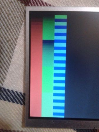

Posted on July 23, 2014 at 23:28
As a last try for tonight, I upload a photo that shows three bars, each supposed to be a gradient from 00 to FF of R and G and B.
Only Red seems to shows an acceptable gradient, G and B are very strange...
Posted on July 23, 2014 at 23:34
What examples does the panel vendor provide?
