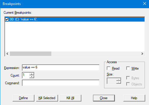

here is my conditional breakpoints settings
I took exercise as <apnt_230.pdf> did at page 11, 15) watchpoints: Conditional Breakpoints.

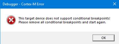

The application can use conditional breakpoints. Why I can't? I got a dialogue saying that My
target device dose not support conditional breakpoints!
Actually, I am using the STMF407 Discovery board as the
<apnt_230.pdf> using.
So, why?

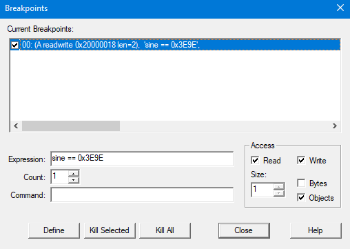

Finally, I found I forget to check the box of Read and Write.

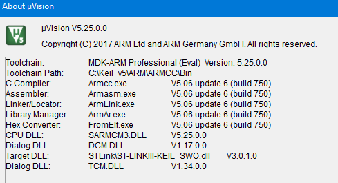

Here is my KEIL IDE details:

I noticed this and by the time I got to answer - you had already found the problem.
You are not the first to forget this - I think there are three others over the years.
So I updated the appnote a bit.  It is now on the Keil website.
Bob
