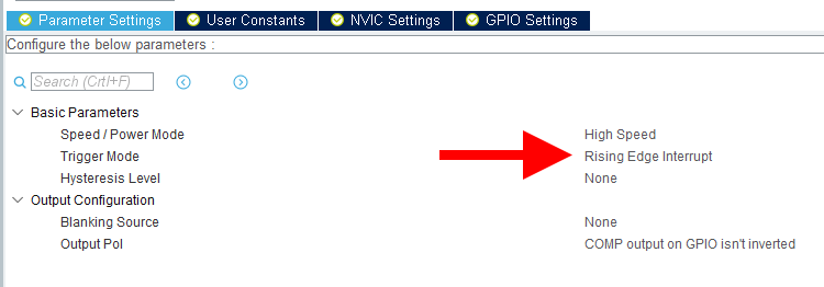

I attach the full code as a file and the relevant part here - for the evaluation board STM32373C-EVAL in which the red LED blinks a few times until the comparator is activated and blocks the execution.
Is there a workaround to make the comparator work with interrupts and the HAL library?
Thanks!

I have not implemented the callback routines in order to show that there could not be any conflict there. You can check the attached file main.c for that. It was created with CubeMX with library version 10.0 for F3 series. With the exception of the comparator and ADC1, all peripherals are on the default configuration for the evaluation board.
I had this problem previously for the same MCU on another project, which was stripped of any other code and all other hw modules were not initialized. The same code with the comparator that blocks on the F3 series works just fine on a STM32F051.

2020-03-23 1:13 PM
So far I have determined that bad things start to happen with interrupt enabled, irrelevant if they are really used:
Rising edge event does not cause this problem.
I presume something went wrong in CubeMX code generation with EXTI lines.....will continue my research....
2020-03-23 8:29 PM
This is how i managed to fix the issue https://community.st.com/s/question/0D50X00009XkhHNSAZ/cubemx-422-stm32f37xx-lib-19-comp-irq-bug
