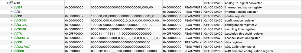

I'm working with an STM32L031F4 and I'm trying to calibrate the ADC to no avail. I'm wondering what it is that I'm missing here.
With the code snippet below, I never get out of the while loop and the CALFACT stays at 0 (if I understand correctly, CALFACT should be updated with the calibration results upon completion).

Don't set ADDIS unless ADEN was set previously.
In other words, remove this line:
ADC1->CR |= ADC_CR_ADDIS; //ensure that ADC is off
and try again.

Read back and check/post the ADC register's content.
0690X00000AQSi8QAH.pngThanks for the reply. I set bit 31 of the CR register (in line 4 of the code snippet above) but it just seems to stay in that state until I reset.

Thank you JW. The calibration is working now...thanks for taking the time to offer some great advice!
