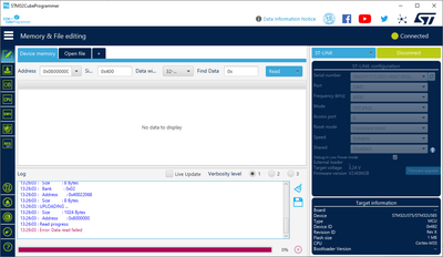

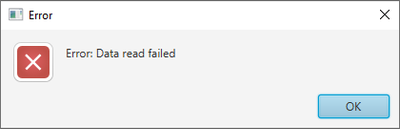

I am in this same situation on a STM32U575.  When I try and connect to the device in Hot Plug Mode as described, I get the following error:
