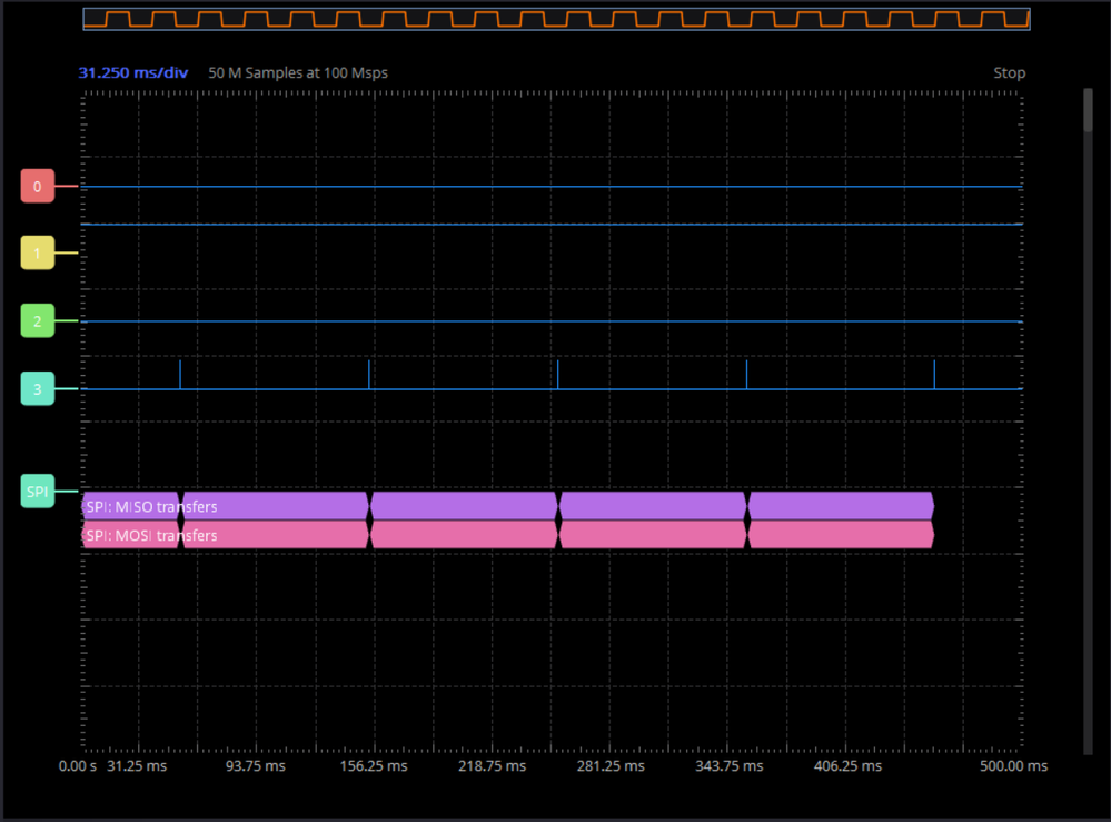

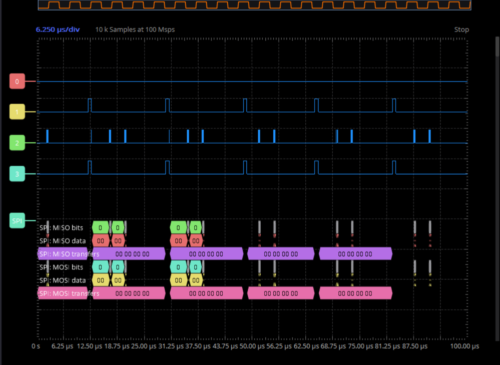

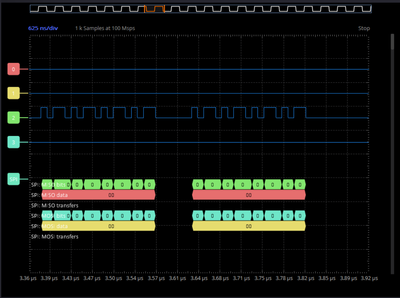

‎2024-03-06 1:29 AM - edited ‎2024-03-06 1:44 AM
- These are the signals I'm getting for STM32L562VET6 :
0 - MOSI, 1 - MISO, 2 - SCLK, 3 - CS
These are the signals I'm getting for STM32L432KC :
Zoomed to view Clock signal
The code used both the MCUs are same with corresponding SPI handlers.
