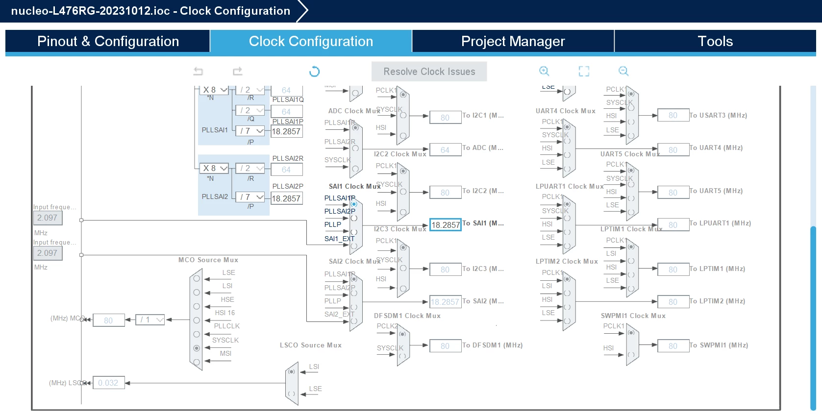

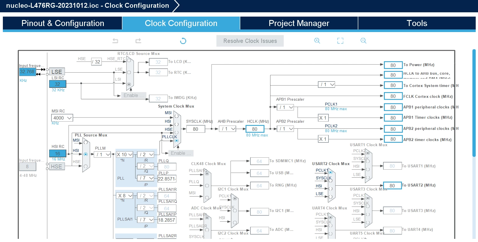

I also attached clock configuration images in IDE. Let me know if any additional information is needed. Thank you so much in advance.

1. Please don't post the same things twice. Even if you reply person X, then person Y can see the reply.
2. Instead of some pictures, the value of the SAI input clock would have been enough.
3. I don't care for CubeMX settings, I asked for register contents.
Now do the following:
- read and understand chapter 43.3.8 of the ref manual RM0351
- check the register settings
- do some math as shown in the ref manual concerning the clocks
Or simply start your CubeMX again, and start setting the SAI to the highest sampling rate you need, then probably it will show that you need to change the input clock settings to the SAI. But that way you will not get any more understanding of the SAI than before.
That said, for 192 kHz you need  256 x 192 kHz = 49.152 MHz.
BTW, audio quality will be terrible with the jittery HSI.

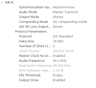

AScha.3
October 16, 2023
easy test , to see whats possible (with your clock settings! ) :
look in Cube, what it calculates for your different output frequencies ->
good clock chosen for 44.1 k ; now when choose 96k as desired output ->
15% too high - but better not possible with this clock setting
so you can optimize for one output frequency always, but for many frequencies will be some compromise.
