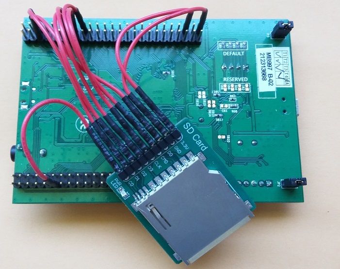

I have a 1GB Lexar that isn't recognized by the current code, seems to be a card version vs supported commands issue.
Older code example worked

I ordered a couple of these to see if anything special/odd about them.
Did you get the PM with the suggested code change need for the 1GB card. The 2GB card (SD) worked without changes, as did the 4GB card (SDHC)
Ended up wiring up a new socket to the F4-DISCO, and testing with that on both SPL and HAL code bases
AShar.8

To summarize again: we have three 256 MB SD Card of Kodak brand. Out of these three, only one 256 MB SD Card is working with 4-bit SDIO.
We found that using 4-bit SDIO, MBR sector is not read correctly from one SD Card. Till now it is observed that while reading MBR (located at sector # 0x3F) in this SD Card, 21st Byte's LSB 4-bits of are missed and replaced by next byte's MSB 4-bits. So, it affected bits of all next bytes to be shifted ahead. After some bytes, it again misses 4bits LSB. This happened almost 3-4 times for reading 512 bytes of MBR sector. Hence, CRC is not matching. So, it is giving FR_NO_FILESYSTEM as it has not found valid MBR.
We have tried using 1-bit SDIO with this non-working SD Card and it works fine! Now all three 256 MB SD Cards are mounted, opened and file can be created with with some text using 1-bit SDIO.
So, now question comes - cannot all 256 MB SD card work via 4-bit SDIO? Should we use only 1-bit SDIO for 256 MB SD Card to make sure that our firmware will communicate successfully with all 256 MB SD Card?
FYI: 16 GB is working via 1-bit SDIO and 4-bit SDIO.
We still prefer to use 4-bit SDIO, if we can found reason and solution. If not, we have option of 1-bit SDIO.
Thanks and Regards.
