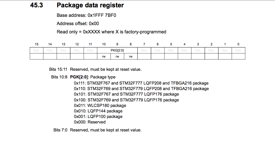

The f303 doesn't seem to have one, but some other stm32 chips (L4, F4, F7 at least) have a Package Data Register that describes the package size
‎2017-05-24 6:59 PM
Any pointers?
‎2017-05-24 7:04 PM
Listed in the reference manuals right after flash size register under the section with Unique Identifier
‎2017-05-24 7:07 PM
Thanks.
When read your post I immediately went to RM0090 (the mid-range 'F4, the oldest ones of all that bunch) and found nothing.
So guess this is a relatively new feature.
‎2017-05-24 7:08 PM
Oh, and those bits are marked as rw...
