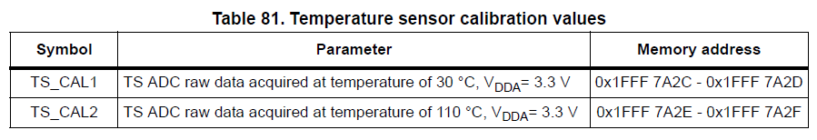

In STM32F4's reference manual (RM0090), it gives a formula to calculate the temperature from the result converted from ADC. But in STM32F429xxx's datasheet, I find it gives a table to show the register address store the calibration values:
I know the temperature sensor in STM32F0 series is calibrated. So, I wonder if the temperature sensor in STM32F4 is calibrated too?
