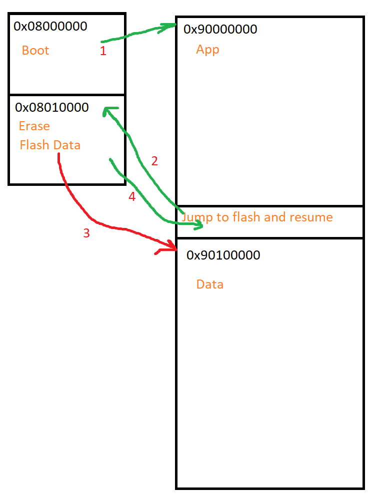

Hello everyone! I have a STM32H750VBT6 controller with external W25Q128 QSPI memory.
The bootloader starts from address 0x080000000, initializes the flash in memory mapping mode and starts the main program from 0x900000000.
There was a need to update the data in the external memory. Since the update must be done via Ethernet, this amount of code will not fit in the 128k flash. Question: is it possible to put the code that directly clears the memory and writes, for example, in the address 0x080100000 and use it there.
How to properly disable execution from SPI for the duration of work from the address 0x080100000, and then return to the same place from where the jump function was called.
Or will this not work?

The memory mapping operation (XIP) can't operate concurrently with the slower "erase, wait, write, wait" operations.
You need to QSPI Abort to break it back into command mode, and not call functions, interrupts, etc that dwell in the QSPI memory space. When done push in the memory mapped command template again.
How can I interrupt the operation of spi if code is being executed from it? I tried calling SPI de-initialization and then calling the function at 0x0801XXXXX. After entering the function, the following command results in a HardFault.
You'd need all the code, call-trees, interrupts to be in RAM or Internal Flash whilst you're interacting with the QSPI content.

I wanted to record data without restarting the controller.
Will it be possible to prohibit interrupts, call the write function from the internal memory of the processor, and then go back, allow interrupts and continue working?
SCB_Disable cache();
Disable Interrupts();
u08 w_err = write_flash(w_data, addr, len);
SCB_EnableD Cache();
SCB_Enablecache();
Enable Interrupts();
Where write_flash() is located at 0x080XXXXX.
When entering the write_flash function, we fall into HardFault at the first step. What am I doing wrong?
The project is large, SSL, MQTT, mbetTLS are used, so the RAM is all occupied.
Pavel A.
Yes, should be possible. To prevent touching the flash area while it is erased, use MPU. But RAM occupied - this is a problem. Whenever you say "HardFault" be sure to investigate and find the actual reason (google...) then we can think of a solution.
