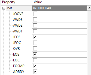

Hello Tesla,
Yes, I should've showed that too. But I have been reading the actual ISR register:
void ADC1_IRQHandler()
	temp_isr = ADC1->ISR & 0x7FF;
	if(LL_ADC_IsActiveFlag_JEOC(ADC1))
		inj_buf[BL - DMA1_Channel1->CNDTR] = ADC1->JDR1;
		loop_cnt++;
		if(loop_cnt >= 1024) loop_cnt = 0;
	else if(LL_ADC_IsActiveFlag_OVR(ADC1))
		LL_ADC_ClearFlag_OVR(ADC1);
		loop_cnt++;
		loop_cnt--;
	else
		__NOP();
temp_isr always reads 0x4B when the breakpoint is reached, which means that JEOC is not set.
0693W00000UoXleQAF.png(I'm only using this for reference, so you can see that 0x4B means JEOC not set)
This happens once in a while, ~ once per 120 seconds.
