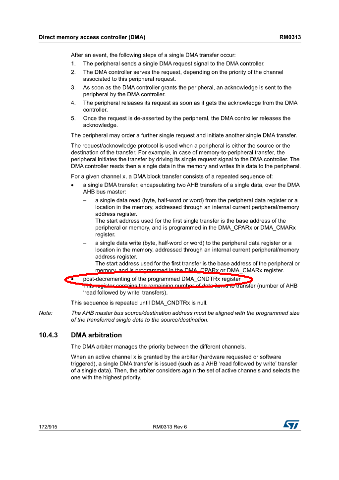

CNDTR indicates you are using a model with single-port DMA. Description of CNDTR in different STM32 models which use it differs, but most if not all explain that it decrements after each transfer.

0693W00000Dq0HhQAJ.pngwith the caveat I mentioned above. I don't have experience with the single-port DMA in this regard.
So if my reference manual says
 post-decrementing of the programmed DMA_CNDTRx register
This register contains the remaining number of data items to transfer (number of AHB
‘read followed by write’ transfers)
That means if I have 2 bytes buffer and the DMA have already filled 1 index at the buffer, that means CNDTR will show 1?
And when the circular buffer have been filled, then CNDTR = 0 and then directly CNDTR = 2 because not it's starting at index 0 again?
I can intepret CNDTR as how many elements it has left to write?

waclawek.jan
Yes.
