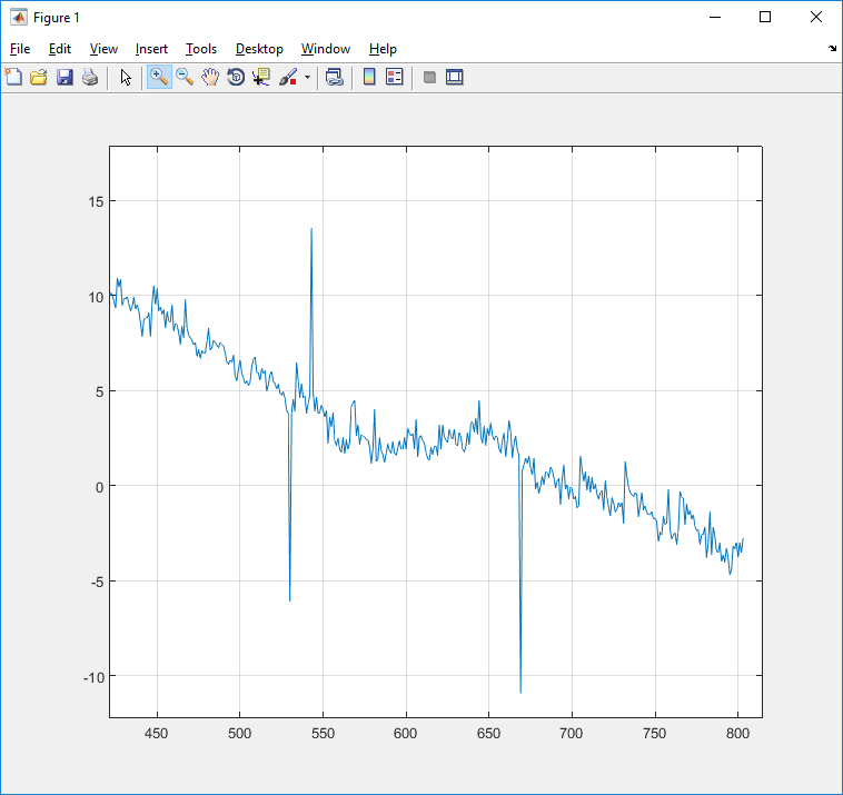

2018-04-11 5:44 PM
FYI - You can see the impact of this error. The spikes in the data are caused by failed conversions on the injection channels. With some work, it was determined, the erroneous reads are simply data from the previous conversion.
