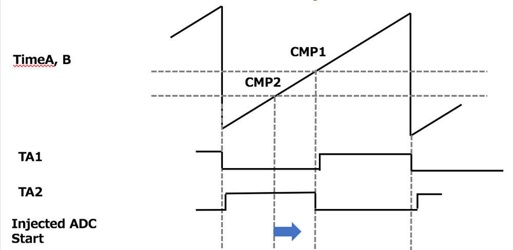

I want to use  injected conversion as shown below.

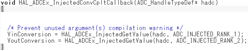

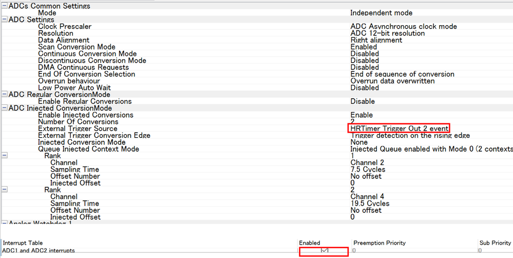

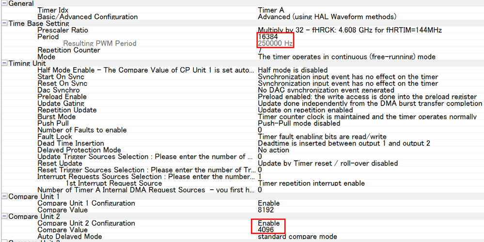

I set up config as below.

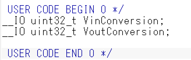

And, I wrote a program as shown below.

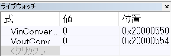

But Injected conversion does not work. VinConversion, VoutConversion should be1400, 800 respectively.

Thank you for your reply. Thanks to your tip, I was able to solve it. I changed HRTIM's AD conversion trigger event from 1 to 2. Thank you.
