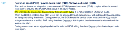

Hello @Anagha_Sasindran ,
The BOR can be enabled or disabled only through option bytes. It is not available in Shutdown mode.
When the BOR is enabled, four BOR levels can be selected through option bytes, with independent configuration
for rising and falling thresholds. For more information about brown-out reset I advise you to take a look at AN5096 application note precisely section 1.2.1 Power-on reset (POR) / power-down reset (PDR) / brown-out reset (BOR)
