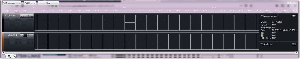

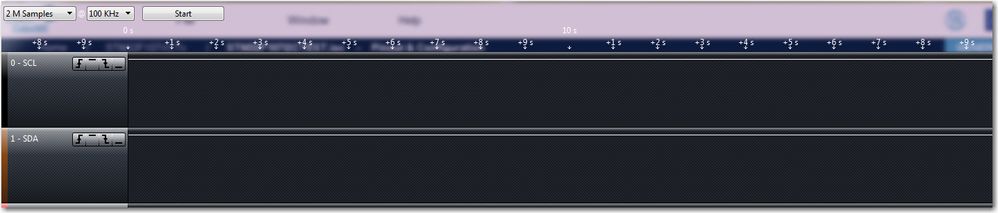

Dear Members,
I tried to initialize I2C in STM32F107
but got the straight line on Logic Analyzer,
I have no idea why ????

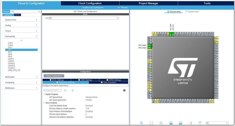

Is it by default in STM32CubeMX, the cpu acts as master ??
I tested PB7 and PB6, they are connected properly into my header pins...
I have no clue why...??

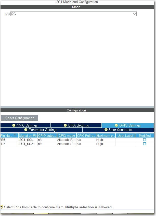

another question, do I need a pull up resistor for logic analyzer only ?
because it's open drain....
The pins look to be high. but yes I'd really think you'd either need internal or external pull-ups for correct operation.
Code doesn't look unreasonable, but not using F1+HAL here.
Going to have to walk hw registers, and external circuit, and check for error/status thrown via functions.
When I test the port as GPIO PB7 and PB6 are ok :
	HAL_GPIO_WritePin(GPIOB,GPIO_PIN_6,GPIO_PIN_SET);
		HAL_Delay(1);
		HAL_GPIO_WritePin(GPIOB,GPIO_PIN_6,GPIO_PIN_RESET);
		HAL_Delay(10);
		HAL_GPIO_WritePin(GPIOB,GPIO_PIN_7,GPIO_PIN_SET);
		HAL_Delay(1);
		HAL_GPIO_WritePin(GPIOB,GPIO_PIN_7,GPIO_PIN_RESET);
but as I2C, no luck yet ??

Is my APB1 Clock not working ?

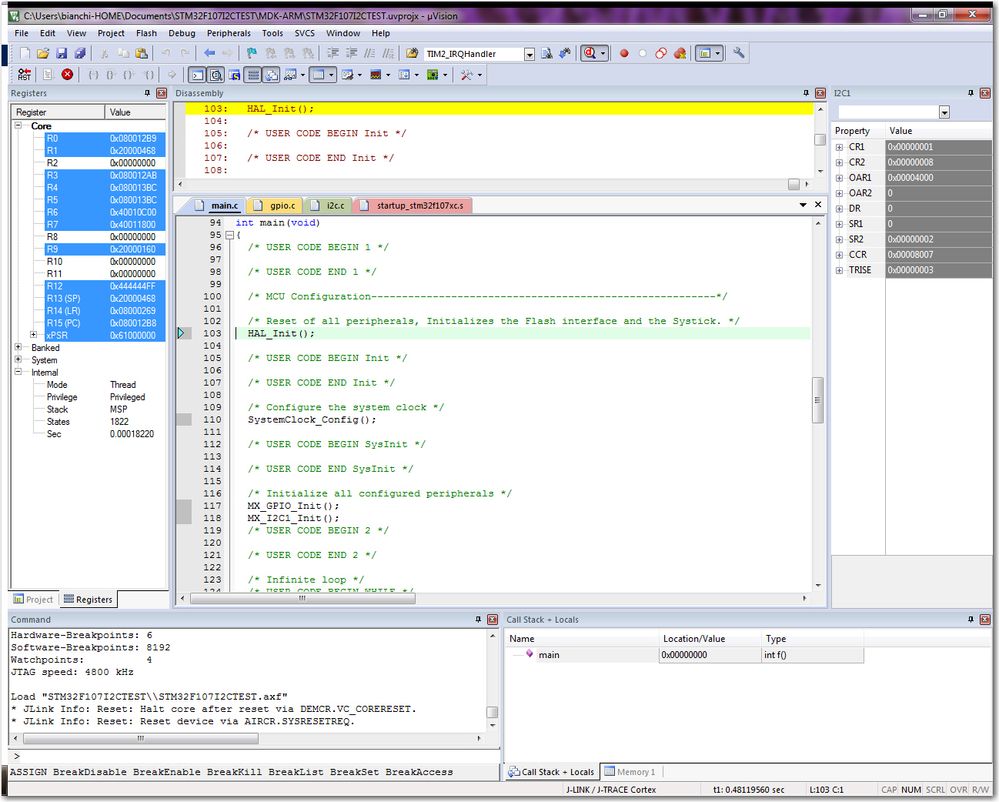

antonius
Senior
the I2C register
