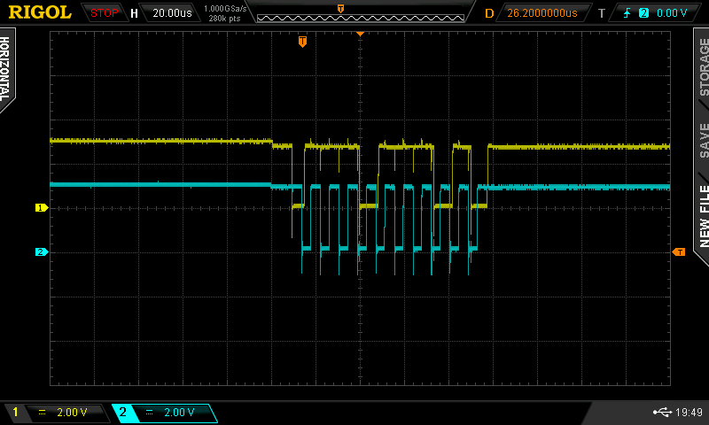

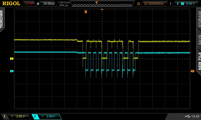

I am trying to communicate with the Barometric sensor MS5611, using the I2C protocol. My micro is STM32f3discovery. The address of the sensor is send, but not the command. The code is stucked in the while loop waiting for TXIE bit to be set. The reason why TXIE is not ''one'', is because the acknowledge bit from the MS5611 is not showing up. Also the I2C status register is setting the NACK (not acknowledge), STOPF (stop flag) bit.
The address of the MS5611 sensor is 11101 This can be seen in the datasheet on the page In my case the value of CSB is zero.
http://www.meas-spec.com/downloads/MS5611-01BApdf
But the O-scope shows me different a picture:
http://s1photobucket.com/user/esovo/media/Newfile1_zps0461710c.jpeg.html

The address bit is the *complementary* of CSB. Try address 0xEE.
laurent
esovo1
esovo1Author
January 7, 2015
Posted on January 07, 2015 at 13:00
Hei Laurent,
I have try it both, but it isn't working. Here is the proof:

Not sure that this may hurt, but can you make sure that GPIO are open drain and not push-pull ?
What about your sensor wiring ? What's the level of PS pin ?

I am a bit concerned with the level shift observed at high level at the moment the I2C starts. Are you sure that you correctly configured GPIO as open drain in the PIO controller of the STM32 ?

Could it be that my timing is off and thats way I get the high bit at 9th SCK place? Is this a STOP bit?
