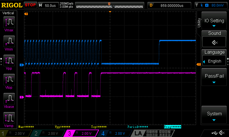

I'm trying to figure our why I'm having an issue with a I2C clock stretching problem.
On my I2C bus I have various devices all work flawlessly apart from one (MCP39F521) that once you have finished a Master Transmit, it stretches the clock - SCL remains low for some time, before going back high ( see  image below ) - but the STM32 doesn't recognize the SCL going back high and leaves CR2 busy bit set... leaving the I2C bus locked...

The MCP39F521 received correctly the data - because I see toggling some pins that are controlled from the payload of the I2C Master Transmit - but I can't read the data coming out.
When I debug step by step the bus SR2 busy bit get cleared, if I run it normally instead I am stuck with the problem...

Wanted to update saying that I found a way around, following this advice:
https://my.st.com/public/STe2ecommunities/mcu/Lists/cortex_mx_stm32/Flat.aspx?RootFolder=https://my.st.com/public/STe2ecommunities/mcu/Lists/cortex_mx_stm32/STM32F105RC%20I2C2%20always%20busy&FolderCTID=0x01200200770978C69A1141439FE559EB459D7580009C4E14902C3CDE46A77F0FFD06506F5B&currentviews=2964
I've ended up resetting the I2C bus after the first write and then issuing the read for the result...
It's not very elegant but now it's working...
I guess the CR2 busy bit is definitely buggy in this situation..
