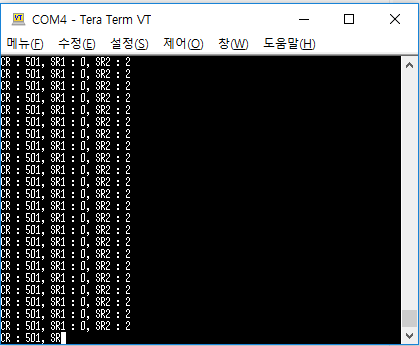

MCU : STM32F405
I wish to use I2C without library.
But, I got always busy flag on I2C_SR2 register
void set_gpio_af_i2c()
RCC_AHB1ENR |= GPIOBEN;
GPIOB_MODER |= (AF_MODE << MODER10 | AF_MODE << MODER11);
GPIOB_PUPDR |= (PULLUP << PUPDR10 | PULLUP << PUPDR11);
GPIOB_OSPEEDR |= (3 << 20 | 3 << 22);
GPIOB_OTYPER |= ( 1 << 10 | 1 << 11);
GPIOB_AFRH |= (AF4 << AFRH10 | AF4 << AFRH11);
I use the I2C2(SDA : PORTB10, SCL  : PORTB11).
Initialize GPIOB10, 11 as af mode4, pull_up open drain, very high speed.
void i2c_setup()
RCC_APB1ENR |= (1 << I2C2EN);
I2C_CR1 |= 1 << SWRST;
I2C_CR1 &= ~(1 << SWRST);
I2C_CR2 |= 42;
I2C_CCR |= 210;
I2C_TRISE = 13;
And I initialize I2C like this, SWRESET, set PCLK, set CCR, set TRISE
I2C_CR1 |= 1 << PE;
I2C_CR1 |= 1 << ACK;
I2C_CR1 |= 1 << START;
// /* Wait until SB flag is set
while( !(I2C_SR1 & 1 << SB) );
Finally, I start like this, set PE, set ACK, set START
But, SB flag dosen't set.
SR2's busy flag always set.
How I can solve it?

Posted on September 14, 2017 at 04:35
Thanks for your reply
I have a hard time in 2 days. OMG.. It just a shift probelm..
I should like this.
RCC_AHB1ENR |= 1 << GPIOBEN;
but i did
-Min Seok
