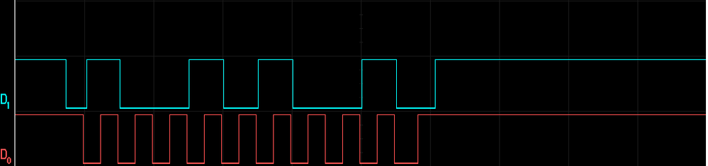

Hi All,
Please see below I2C protocal:
I am using STM32F401 Discover Board, the slave is on board CS43L22, the address is 0x94.
I try to send 0x01 to register 0x02:
Single_WriteI2C(0x02,0x01)
, but only send out address, no data phase.
I think it cause by slave not ack
The low level driver is
 stm32f4xx_hal_i2c.c
, if I using old stm32f4xx_i2c.c, the result is OK. So I do not know what is going on.
The complete code as below:

According to some information from internet, I change slave address from 0x94 to 0x96 or 0x4A, the result still the same. I also tried to slow the I2C speed, still useless, I can only see address on the oscilloscope, no data phase. Just like slave not there.
Any idea ??
mailbox4ad4
Posted on April 21, 2015 at 09:02
Solved...I forgot to set Reset pin at High Level....stupid...
