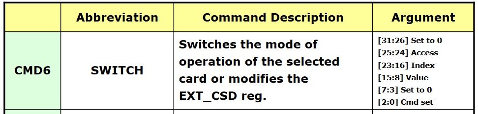

I'm looking for information on the cmd6 command for sd cards.
Posted on March 11, 2018 at 21:48
Good rest of the day.
There is a problem.
I'm looking for information on the cmd6 command for sd cards. The available information is not complete.
https://community.st.com/external-link.jspa?url=http%3A%2F%2Fzxevo-files.perestoroniny.ru%2Fngs-read-only%2Fdocs%2F_sd_card%2Fsd_physical_specs_full_2009.pdf
And very different from different manufacturers of sd cards. If I understood correctly, there is no single standard.
The cmd6 command transfers the sd card to fast mode, one switch per call. Available from official standard functions:
1) the inclusion of 1-4-8 data lines
2) the inclusion of the standard bus speed 1 ~ 25MGz. (Unique)
3) the inclusion of increased bus speed 50-100-200MGz. (unique)
4) enabling DDR mode, DDR2 for data. (duplicated by other teams)
5) Switching on the power supply 1.8V (for SDXC) (duplicated by other commands)
6) programming of a unique user function. (unique)
I'm interested in the format for representing the command argument. I often met the magic numbers, but this is not enough.

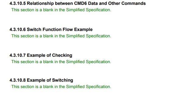

AVI-crak
AVI-crakAuthor
Senior
Mar 12, 2018 12:00 AM UTC
Posted on March 12, 2018 at 00:00
Thanks for the picture.
For an incomprehensible reason for me (your documentation address) - the section of the descriptions of the arguments is displayed as simplified. I looked through the documentation along and across, there is not this picture. Probably you need to break down the documentation - to see everything hidden, but I do not have a key.0690X00000604T6QAI.jpg
