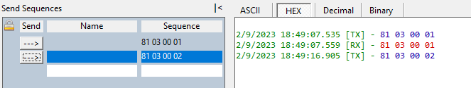

Im Try to receive the serial data frame from dock light but .I cant able to receive serially.
my Frame HEX Formate :81 03 00 01
This my code:

Output:Docklight
[TX]=81 03 00 01
[RX]=08 40 50 00
this my Experted output:
[TX]=81 03 00 01
[RX]=81 03 00 01

So many things.... To start with:
  • Look up what HAL_UART_Receive() actually does, where it puts the data and what values it returns. Hint - it doesn't return the UART data, it returns a status code.
  • Transmit() returns a pointer to a LOCAL array, which disappears as soon as the function returns. You code might APPEAR to work only as long as you don't call any other function or get any interrupts. But don't count on it.
  • Once you figoure out how HAL_UART_Receive() actually works, re-visit your for() loops

This code will give you a basic idea of how to receive binary data. When HAL_UARTEx_RxEventCallback() is called, the rxData already holds the data so you can set a flag so you know there is new data ready. Then check the flag in the while loop.
Using HAL_UARTEx_ReceiveToIdle_DMA() allows you to receive a variable length data packet. In this case you are wanting to received 4 bytes. So even though the DMA is expecting 16 bytes, the Idle bit will cause an interrupt after 4 bytes are sent from Docklight. You can check the Size to be sure you did receive 4 bytes for a complete packet and then set a flag.
The 1st packet matches your format so a copy of it is transmitted back to Docklight. The 2nd packet doesn't match so the code ignores it
