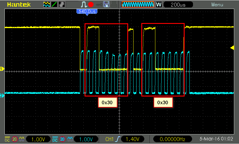

I don't know why STM32F427 I2C3 will send the byte repeat?
yongjie989
Posted on March 04, 2016 at 17:38
Hi all,
Are there have any one know this problem, I have to trying send only one byte via I2C3, but
uint32_t I2C_WrBuf(I2C_TypeDef* I2Cx, uint8_t DevAddr, uint8_t *buf, uint32_t cnt) {
  I2Cx->CR1 |= I2C_CR1_START;
  I2Cx->DR = (DevAddr << 1) | I2C_Direction_Transmitter;
  I2Cx->DR = 0x30;             /* Here is very simple to send one byte */
  I2Cx->CR1 |= I2C_CR1_STOP;

Posted on March 04, 2016 at 18:55
Wouldn't you need to wait for the register to free up before jamming in the next value?
yongjie989
Posted on March 05, 2016 at 07:58
I have try to wait, but still show same result. But if I use I2C1, I2C1 is no this issue.
