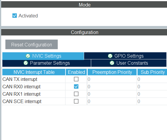

This is how I have done:

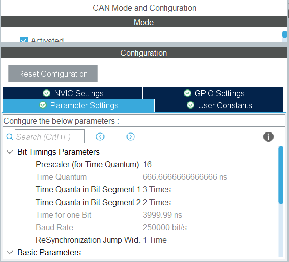

Step 1: I KNOW that the ECU has 250 kb/s baudrate. So I tune that in inside STM32CubeIDE
0693W00000D0FMiQAN.png0693W00000D0FUmQAN.pngStep 2: Then I create my CAN-bus layer code. It's for STM32F3 if you wonder.

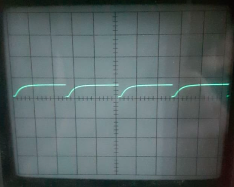

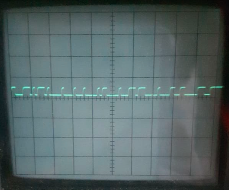

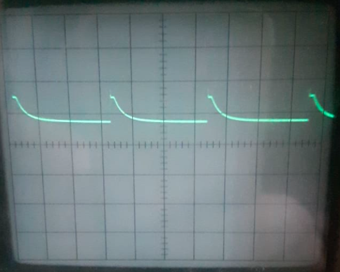

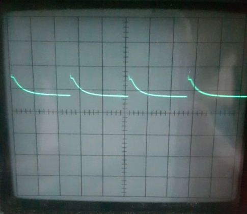

I hook up an oscilloscope and analysing the signals.
Settings:
1V divider
20 uS sweep time
CAN+ from my STM32 board:
This is a request ID for Address Claimed = 0x00EE00
ID = 0x18EA8022 = 0b00011000 11101010 10000000 00100010
DLC = 3 bytes
DATA = 0x00EE00 = 0b00000000 11101110 00000000
0693W00000D0FWiQAN.pngCAN+ from the ECU:
0693W00000D0FWxQAN.pngQuestion:
Judging by the CAN+ signals, how different they are. Can it be that I have seleted wrong baudrate?
Why can I read the signals from the ECU, but not write to the ECU?

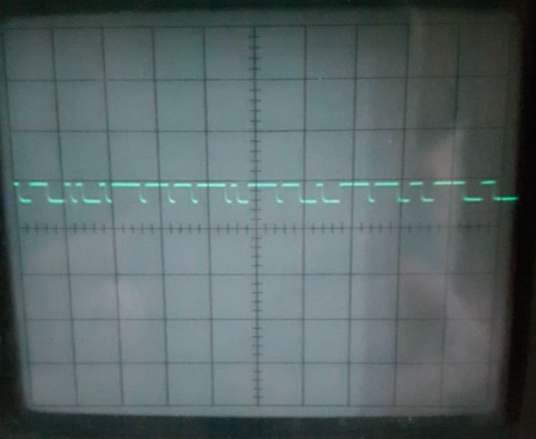

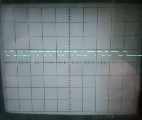

Edit:
Here is more pictures. The same settings as above.
CAN+ and CAN- from ECU
0693W00000D0G8wQAF.png0693W00000D0G9LQAV.pngCAN+ and CAN- from STM32F3:

Is the STM32 flagging any error/status?
The CAN+/- look Ok
Have you tried a pair of STM32 talking to each other, or CAN1 to CAN2 out-n-back test?
Perhaps look at what the transceiver is doing.
I'm only having CAN1 and only one STM32 board.
The transmitt function gives HAL_OK.

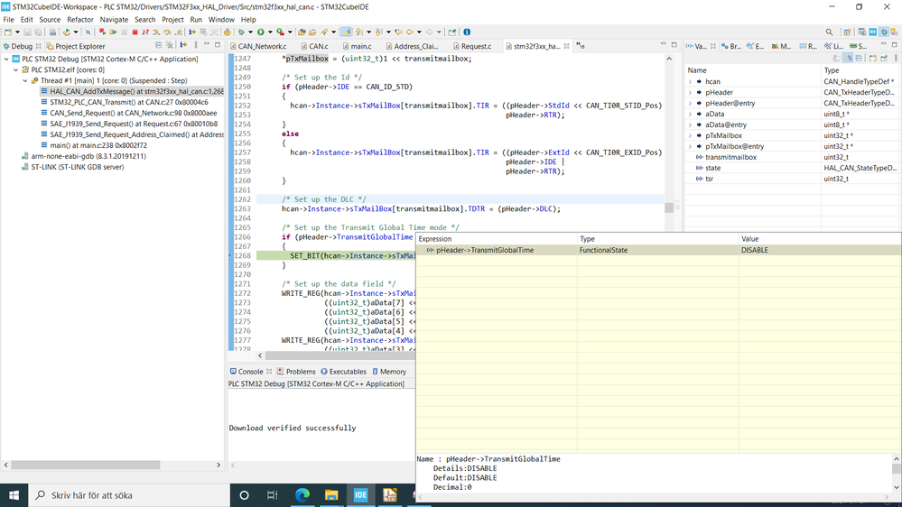

By the way! I notice something weir.d
This code runs, even if TransmitGlobalTime is DISABLE
      /* Set up the Transmit Global Time mode */
      if (pHeader->TransmitGlobalTime == ENABLE)
        SET_BIT(hcan->Instance->sTxMailBox[transmitmailbox].TDTR, CAN_TDT0R_TGT);
Have a look

Is there any way I can put CAN- constant low and CAN+ constant high in STM32CubeIDE?
I want to measure the voltage between CAN+ and CAN-. Perhaps the voltage is to low?
