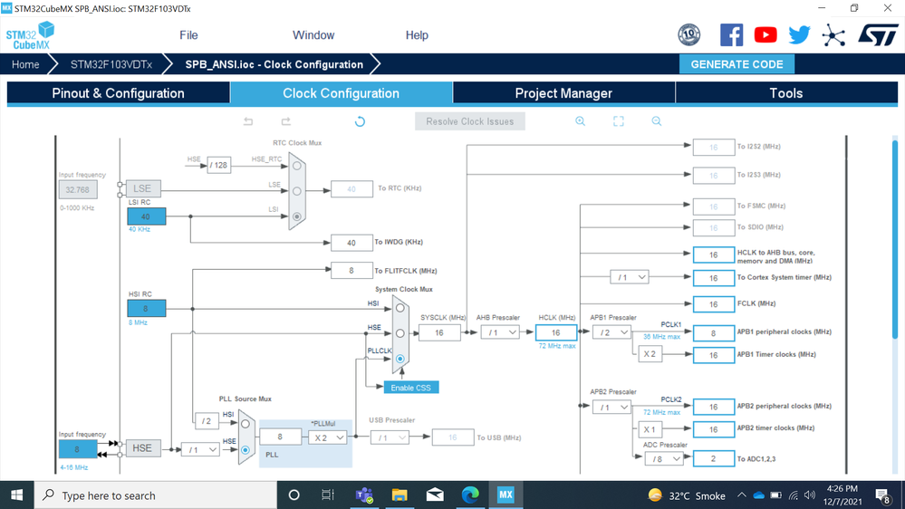

I am using stm32f103 for project and keil ide for the compilation. I have configured timer 2 having 16 MHz clk frequency. I need to generate interrupt at 100 ms so I have configured Prescaler val as 24 and period val as 63999. but getting at 95 or 112 ms

Welcome, @PGare.1​, to the community!
do you use HSI as clock source?
Regards
/Peter
‎2021-12-07 2:57 AM
Thanks for reply. No We are using HSE as clock source
‎2021-12-07 3:13 AM
OK.
Did you check the frequency coming from HSE using e.g. the pin MCO?
How did you measure the duration of TIM2?
Regards
/Peter

//**********************************In main.c********************************//

with help of USART1. Printing A on serial terminal when interrupt get generated. timestamp is logged in minicom utility on linux
‎2021-12-07 4:34 AM
The duration of the timer should be measured as directly as possible, e.g. by switching and measuring on a GPIO.
printf is not suitable for this use case, especially if its output is sent to Linux, which is not an RTOS with a predictable response time.
