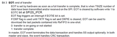

LL_SPI_SetTransferSize(SPI4, 4);
LL_SPI_StartMasterTransfer(SPI4);
LL_SPI_Enable(SPI4);

To be precise, it is not possible to escape from the while (!LL_SPI_IsActiveFlag_EOT(SPI4)); of the Spi_wr_Opcode function.
Also, spi clock and mosi are not displayed.

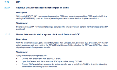

I advise you to read this AN5543 and the STM32H7 errata in SPI section to check if the limitation is part of your issue.

Need to set TSIZE if you want the EOT flag to work.
