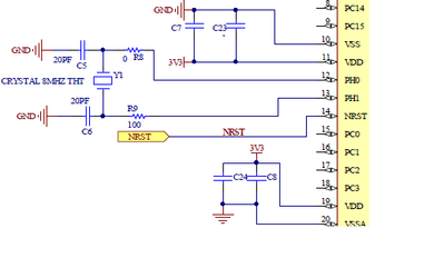

I am trying to powerup external 8MHZ crystal on STM32F407VET6 MCU but it is completely dead. I run the LED bliking program using HSI, and it is working sucussfully. Boot 0 and Boot1 pins have been PD with 500 ohm.
 I also run the same code to use HSE on STM4 Discovery board after removing R68, I see HSE on board is working.
Below are my caclulation
Frequency = 8 Mhz,
Co = 7 pF ( as per datasheet)
CL= 10 pF ( as per datasheet, used 20pF CL1 and CL2)
ESR = 100  ohm ( as per data sheet)
After calculation gmcrit comes..
gmcrit = .287
gm =  5 ( from ST data sheet)
gain margin = 5/.287 = 17
so gain margin > 5 condition is met.
I also changed Rext  to 0, 100, 200, 500 , 1000 ohm. HSE is dead.
PCB design seems ok , and I assume for now no issue with PCB design.
I have gone through AN2867, but not sure what point I am missing.
Kindly suggest where could be the fault.  I eliminate software issue as same code is making HSE work on Discovery board.

Crystal can be defective or its parameters are out of MCU acceptability. Try different crystal (from Nucleo board). You can try also 1Mohm rezistor paralel to crystal.
Peter BENSCH
Your calculation is generally correct, and HSE should work on the lab bench, although the values for CL1 and CL2 are a little too large. You should also consider the board and pin capacitance and dimension CL1 and CL2 to 12...15pF, for example.
However, you have only shown a section of the schematics:
  • Does VDDA have the same potential as VDD?
  • What potential does VREF+ see?
  • Are all VSS connected to GND and all VDD connected to the supply voltage?
  • Do you have the 2.2µF capacitors on the VCAP pins?
  • Why don't you have a 100nF capacitor on NRST?
  • BOOT1 does not have to be at 0, but this does not matter if BOOT0=0 (see AN2606, pattern 1)

Please find answer
VDDA is tied to VDD
  • What potential does VREF+ see?  VREF+ is also tied to VDD
  • Yes  all VSS connected to GND and all VDD to supply voltage
  • Yes, 2.2uf connected to VCAP1 and VACP2,  I see voltage there around 1.2 V,    VDD is 3.3V
  • 100 nF with GND is connected to NRST , NSRT is also PU by 3.3V.
I am using one from Nucleo F091RC board. I aso connected 1Mohm parrallel to crystal. But no success.

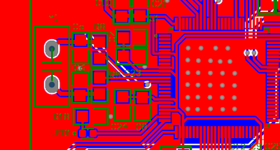

uC oritentation is correct as LED blinking program is working using HSI. I changed CL1 and CL2 but same situation. I am yet to try with lower CL values.
Pls find the pcb layout.
Peter BENSCH
Well, the layout is an example of how not to build it:
  • crystal too far away from the STM32
  • signal(s) underneath the crystal
  • GND around the crystal completely unsuitable:
    • no guard ring around Y1, no separate GND area underneath (see AN2867, section 7.1 and 7.2)
    • No separate and direct GND connection to pin 10 of the STM32
BTW: NRST does not require a pull-up as it is already installed (see RM0090, section 6.1.2). Yes, I know that a pull-up can sometimes be found, e.g. with the Blue Pills from Asian suppliers - which is still not correct.
